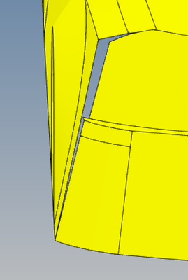

Is there a good way to try and find this open places?
Turn off Translucency.
GapsGaps
I suspect that this one you are going to have to strategically stitch and trim and stitch.
It will take some work.

Message 9 of 16
JDMather
I didn't get very far before I noticed this lack of symmetry.
Is this intended?
