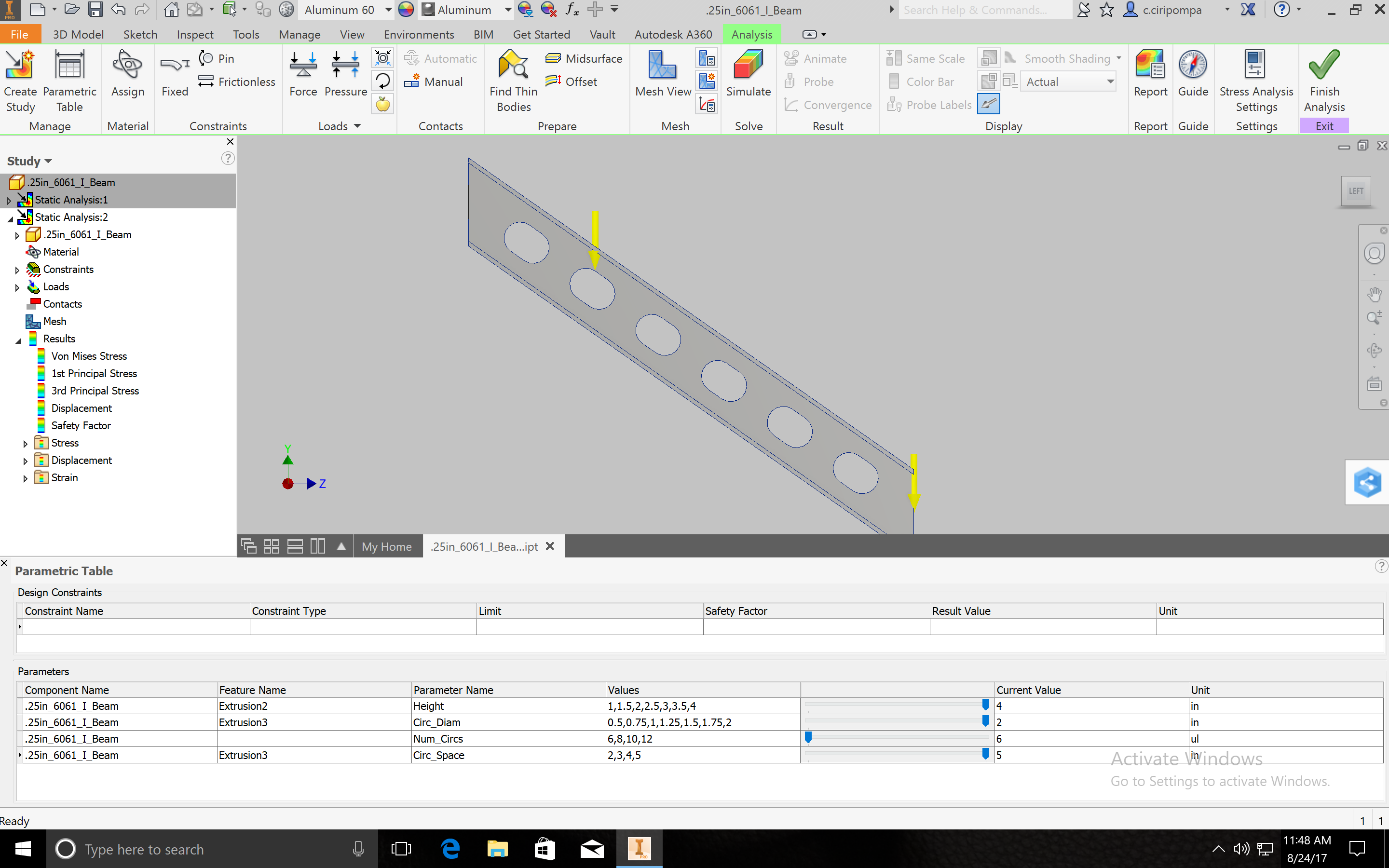

I'm running stress analysis on a part right now and am testing many configurations through the use of parameters.
Is there a way to constrain the parameter configurations, if you look at my screen shot for example, so that Circ_Diam has to be .25" less than Height?

Hi Cade,
It is a very interesting requirement. In Modeling environment, this can easily be done using iLogic rules. But, I don't think such logical relationship can be established in Stress Analysis environment at the moment. Please feel free to submit an idea to Inventor Ideas forum.
Many thanks!
