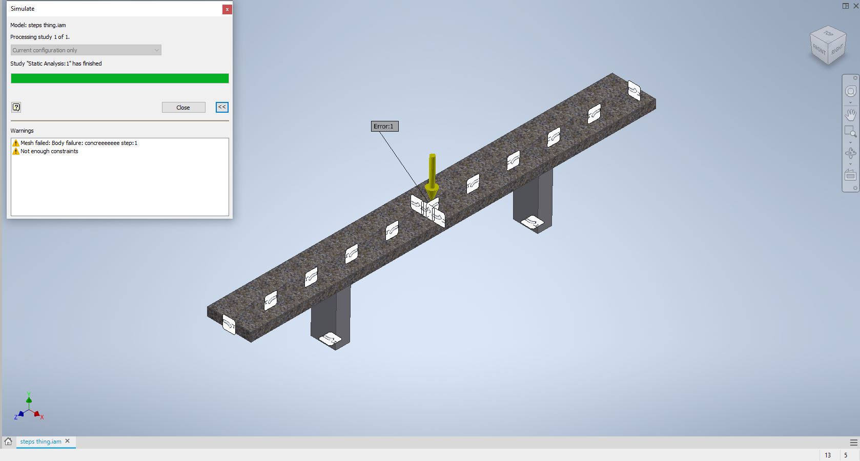

I was using the Stress analysis function on a concrete step with rebar in it and it is showing the body has failed. I applied the stress onto the concrete, which has rebars going through it. I have provided a screenshot of the failure and the orthographic/isometric associated with the step.

Concrete is not isotropic.
Inventor FEA is limited to isotropic material properties.
I suspect that you have other issues with your setup that are not material related.
