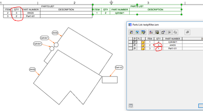

@Jon.Dean No its not.. Its also an issue when you split the parts list ONLY once with filters set post split..
Here is the parts list split once, then filters applied.. notice quantities in parts list dialog are correct but the single split parts list is not..
@johnsonshiue johnson.. Images and dataset attached..
The way it should work is that all sections (all splits) of a parts list should update to match the parts list dialog quantities when filters are applied.. Plain, simple and logical..
