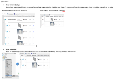

A.Acheson
I am thinking that the idea of a spare parts sub assembly from @Frederick_Law  is the most straight forward and easy to use approach. I am not totally sure of your process for creating qty's for purchasing and how your displaying the BOM to the Assembly crew so really there is many way's you can work with the assembly approach.  Either directly in the BOM or in the Partlist in the drawing.
Some potential workflows in the BOM:
  1. You could just have the assembly completely independent of the main assembly and in your BOM export to excel combine the parts qtys either manually or by code. Obviously this might not be a very transparent method and open to mistakes.
  2. Create a sub assembly in the main assembly and add physical parts to the assembly. This way the total counts for BOM export are correct for purchasing. This however brings a drawback in that the qty's for assembly purposes are now incorrect as they include the spare parts and there maybe confusion as to the extra qty's. A solution is to set the Sub assembly  Bom Structure to Normal in the assembly when exporting BOM for ordering then switch the Occurrence Bom Structure to reference afterwards for Assembly Accuracy in the Drawing.
Manual approach to solve the qty potential confusion.
And here is an optional code method to work with a spare parts sub assembly. I have chosen to add correct qty's of occurrences as the mass is then correct for the assembly in case you want to check shipping requirements etc.
