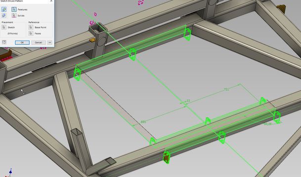

torbjorn_heglum1
You can use the face button to orient the instances of your sketch driven pattern.
- Select a face where the original feature is placed, and corresponding faces for the rest of the instances
- if no such faces are available in the real model, I normally create an additional  surface for this purpose
The picture below shows a bracket in a master model that is patterned with variable distances and orienation.
On the detail below you see that the orientation id changed, as wanted.
Works quite well, but bugs out some times where faces are 90 deg on each other, the instances can flip 180 deg.
Torbjorn
IV2017.4
