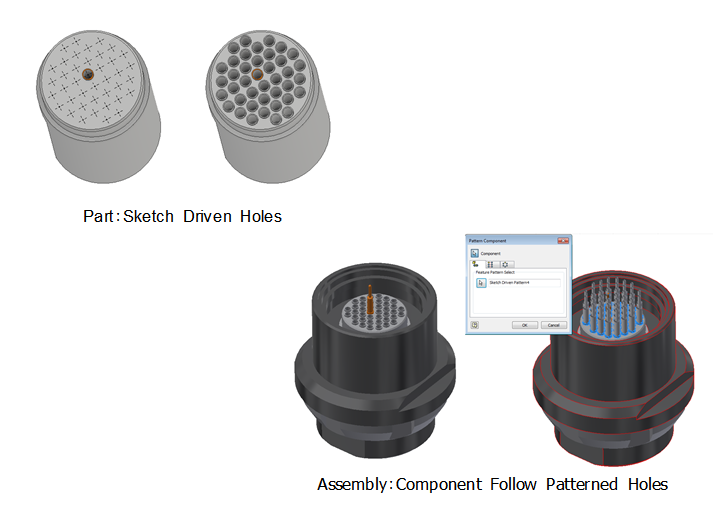

I attached two customer cases for sketch driven pattern as well.

@Steven_Gao wrote:
How is this picture achieved? Are those points places with Excel-coordinates?
I wonder how those points were generated, because they are following a variable diameter helix & they seem to unequally distanced based on angle around the rotation axis.
So far I could not imagine any fast way to do this in Inventor.

Steven_Gao
Hi Patrick,
Please get the details and models from the original post: How to Create a Sketch Driven Hole Pattern Normal to a Curved Suface . My comments about the points as following - “It looks like the work points may not be on the curved surface accurately.So I have to new a 3D sketch and use the Project to Surface command(Project to closest point), select the all work points(window selection) and project them to the outer curved surface, and then select all points and change their type to Center Point. Finally, I used the sketch driven pattern and generate the all cut features and they are normal to the curved surface.
