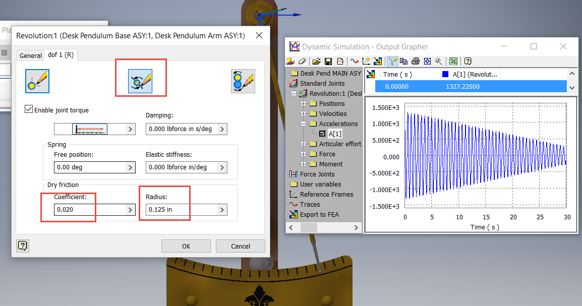

Simple Pendulum Simulation
billjenkins
I can’t seem to figure out what joint to use and how to set up friction for a pendulum simulation. I would appreciate it is someone would look at my .iam. I have a revolution joint automatically made that works but the pendulum never stops swinging.
Inventor Pro 2009
Windows 7 32 Bit
