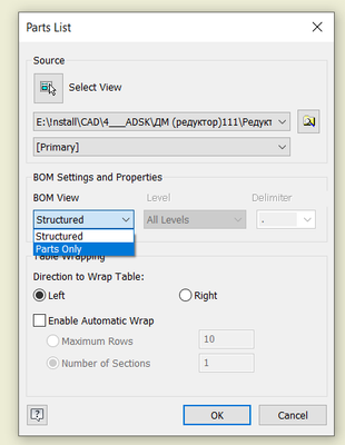

Alexander_Chernikov
When you insert a parts list for the first time, you can also select "Parts Only"

CCarreiras
If you wanna have all the duplicates summed (from the main and every subassemblies), you can create a "parts only" list.
Note: you can't have both types of part lists in the same document, so, you can create a doc to have all the structure detailed (Structure list), and another document for purchase proposes and use the parts only list type to have the total of each content center component summed.
