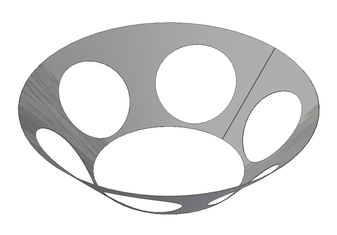

Does anyone know why on a rolled sheet metal part, the corner round feature does not flatten out properly?
In the past we have used the old "delete face & thicken" trick, but this has to be done manually if you have a pattern that changes dynamically like we do.
I am trying to get away from delete face since it requires more time and manual intervention.
Attached is the part in question and example images.
The reason this is a problem is because when this flat pattern is used by other programs, it creates issues.
Anyone have any ideas how to fix this?
Thank you for your help!

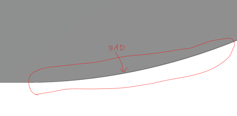

If you go to the flat pattern and zoom in tight to the corner, you can see that there are 2 "arcs" where there should only be 1.
bob_holland
Autodesk Support
Autodesk Support
@chrisw01a
I see what you mean.
It is kind of like there is a draft angle
It is even worse with a Chamfer.
Thank you for bringing this to our attention.
I will be sending this to our development staff.

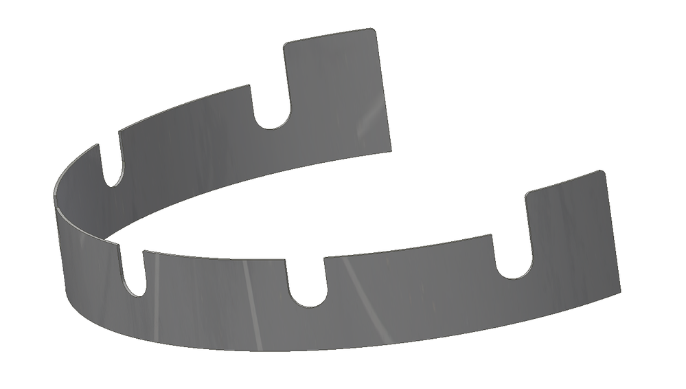

I have uncovered some "bugs" with the "cut normal" option in the sheet metal "cut" feature that I would really appreciate some help with.
There are a couple of particular parts that have been a thorn in my side for 14 years and the cut normal feature would save me hours upon hours of extra time each year IF it worked properly.
Please let me know how I can contact you to get you the information.  If you would like, I can send you a link to a post with examples...
Here is what the part should look like...
Using a loft cut (this is what is SHOULD look like)
And here is is after the "cut normal" is applied
 Using the "cut normal" feature
There are other issues on this but this was just a quick example.

Hmm. IMO, corner rounds and corner chamfers can only work right by theory on plain surfaces, not cylindrical ones. If a corner round on a cylindrical surface is needed, then an Unfold-Refold should be done, and the corner round or chamfer be applied on the flattened sheet.
I've placed a sample (2017) in Chris's file with the red corner round. As can be seen, to three other rounds axes can be set. That's nice, but not ok in theory.
On the other hand, no axis can be set at the red round.
Smiley Wink Perhaps sometimes that's no good, but the benefit of these rounds is the perfect Flatpattern.
Walter
Another issue: These corner round axes are more like a fake. They should be meeting in a single point of the center axis, but they don't.

IgorMir
Thank you, Walter.
That in turn might lead us to re-think the modeling practice a bit. So, if Unfold is used - then in there all the filleting/chamfering should be introduced prior to Refold. That way the final Flat Pattern will be free from unwanted extra lines in corners.
