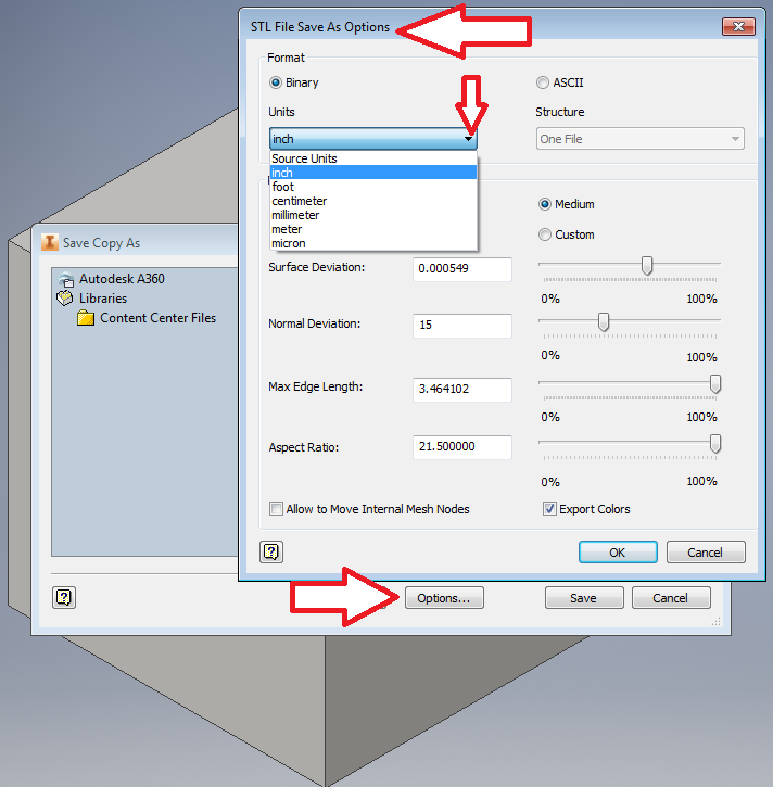

In Inventor 2016,,,I saved a file as an stl file. I have units in inches.  When I measure the file in fusion 360 it is showing .20 inch instead of the correct 2 inch.  The scale seems to change when saving to stl.  Is there an adjustment for this?

Did you click Options and set your save units the same as the document units?

so Inventor document units are in inches..
What units did you select for the stl options during the save copy as process? (the options button next to save)
What units are you using in fusion (think its preferences--default units --design)
stl files are unitless and thus you need to ensure both systems are setup to export/import to the proper units..

Hey Thanks..options box for save,,worked,, changed units there,     I use fusion to do measurement checks after file conversions. Make sure scale is correct.
