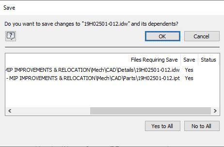

Been noticing this and kind of a time killer working on a simple drawing of a simple part.  Click the Save button at the top of the menu bar, set everything to YES, click OK and do it again.  So basically saved it twice.  The very next mouse click is closing the drawing and I get prompted saying there have been modifications to the files and asking if I want to save the files.  When I say YES it shows me both the drawing and the part require saving.  Why the heck do I need to save immediately after I saved without doing a single thing???

phlyx
Had a drawing open, did a Save, set everything to Yes and saved everything.  Then went to Help and About Inventor, then CTRL+D and got the popup below.
Yet when I try to close the file it tells me both the drawing and the part needed saving:
Confusing....

phlyx
Found something that stopped this action.  Just testing around and when I set Application Options/Save/Embed Translation Report in Document to Do not create translation report my workstation functions properly.  When I click save on a drawing I just opened it doesn't prompt me for anything.  When I click the X it just closes the drawing with no prompt.
Seems all fixed BUT (and there always seems to be a but) the engineer who was testing the same drawings as I was access has his set to Embed Translation Report in Document and he doesn't get the prompts.

Message 10 of 19
phlyx
It's not file specific but I just tried some things to see if I could nail it down a little more.  I went back to the project and parts I was getting that dirty state with and now it wasn't doing it.  I could click Save, click X and it closed.  Then I made a minor change to the iProperties, clicked Save, then clicked the X immediately after and then I got prompted to save the file again.
If I save again, close it, re-open it and just click the X I get the same prompt.  If I open an assembly or a drawing that part is in, the assembly and the drawing does the same thing when I try to exit that file.   Also if I open a part and edit the part without changing the iProperties then I get a different prompt but forces me to do a second save right after saving it.
And once a file gets changed in any way, if you have an assembly or drawing open that has that component in it, it stays dirty regardless of how many times you save it or close it.   Once you save or close the assembly and/or drawing so no instances of that file are open, then it's like it resets itself and everything is good again.

phlyx
Hey Johnson,
Nailed it!!!  I found a part and changed some iProperty a little, saved, closed and got prompted.  Did it but didn't change iProperty and it closed.  Repeated to be sure it was the same every time.  Set iLogic to not load automatically and had to restart Inventor (guess it can't unload while running).  Opened the same part and did it again and no matter what I did to iProperties when I clicked the "X" it just closed.  Looks like the guilty party is us.  I'll dig into that and post whatever I find out.

liam.dewhurstNMKYG
Hey Johnson,
I think I figured out why it's happening.
It's our upRev automation, where if you change the rev of the drawing it changes the rev of the part. (our factory references the rev of the part & rev of drawing)
However this automatically pushes the rev back to the part every time we save (iTrigger). So anytime we save it changes iProperties (frustrating). Is there a way to do a checksum with an if/else loop so that we check if the drawing and part match rev, and only push the ipropoerty change if they don't match?

bshbsh
if odoc.PropertySets.Item("Summary Information").Item("Revision Number").Value <> odrawdoc.PropertySets.Item("Summary Information").Item("Revision Number").Value then
odoc.PropertySets.Item("Summary Information").Item("Revision Number").Value = odrawdoc.PropertySets.Item("Summary Information").Item("Revision Number").Value
end if
Message 17 of 19
liam.dewhurstNMKYG
Hi Bshbsh,
This worked like a charm, thanks!
