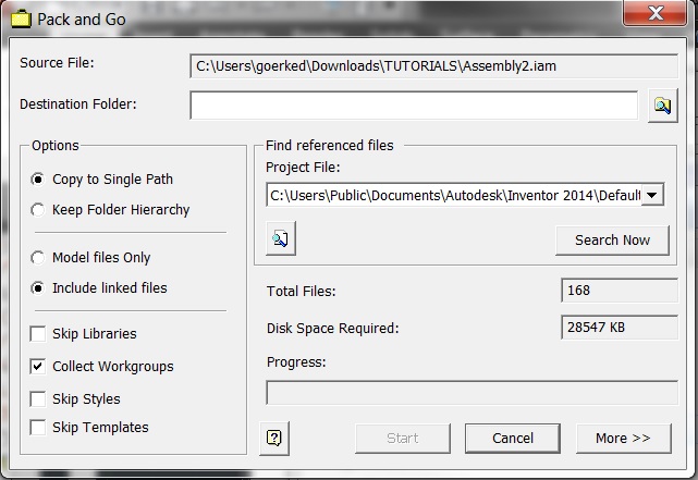

Okay so I have some good computer skills, I've been using a computer for over 20 years.
Not just for work but at home too, for many different things but this Pack and Go thing has me confused.
Like this for instance:
That is the name of the assembly file.
So then I get this:
So I'm guessing that I need to do something with the destination folder but I'm unsure.
If it worked the way I would expect I would just be able to select all of the parts currently being used and pack them all together and send off the zip file.
This is the problem with not having someone right here at work that I can learn from and watch as I go along.
Message 12 of 17
CCarreiras
Hi!
You have to give a destination folder. In this destination folder you will have the copy. Zip that destination folder and upload it here.
Also make sure you skip templates and styles, or your file will be bigger then you need.
Read about "Project Files". But now, i think you can skip the warning and continue.
CCarreiras
Message 13 of 17
The way that I believe I've done it in the past is to set the destination folder, unselect "Include Linked Files" and just leave that as "Model Files Only", I don't believe I've left the "Collect Workgroups" box checked in the past. Then once you're there, you click "Search Now" and it will do a quick memory check then you click start. It will think for a minute or two depeding on the size of your assembly then once it is done, click done.

Thank you to both WiMann and JDMather for all of your help with this stupid problem.
I really appreciate all of the help!
I understand how it can be since I have helped others myself on a couple of different forums that I belong to.
Okay so here is my zipped folder.
