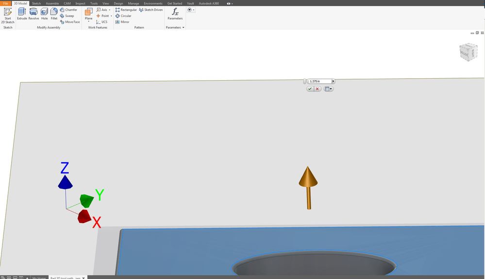

rgollob
@johnsonshiue wrote:
Hi! Could you try something real quick? Go to Tools -> Application Options -> General -> Annotation Scale -> change it to 5. Now select a workplane. Does the grip point show up?
Many thanks!
Unfortunately, no, it just made the direction arrows and such really large.

johnsonshiue
Hi! The screenshot simply shows that the grip points do not appear on the 4 corners of a workplane. The behavior does not make sense. Could you try using Inventor Reset Tool (Programs -> Autodesk -> Autodesk Inventor Professional 2018) -> Tools -> Inventor Reset Tool) and see if it helps?

rgollob
Or, could you disable HSM add-in and see if there is a difference.
Many thanks!
The Picture was intended to should you the result of your previous instruction. However, yes you can also see that the grip handles are not there.
