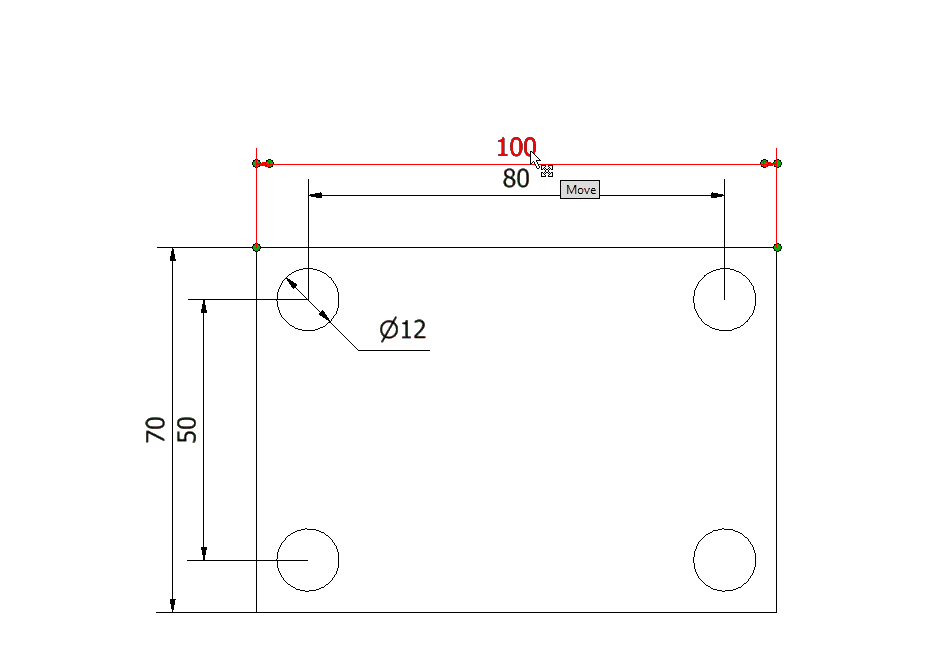

salariua
In general all the recommendations are to use drawing dimensioning and tolerancing functionality. The assembly tolerances are mainly used in interference check, stack-up etc. I do use them in parts trying to maintain the design intent especially when cloning and copying parts.
This is a bug.
Retrieved dimensions should be editable (value and tolerance) only via right-click Edit Model Dimension. If you want different value or tolerance then place a dimension in the drawing which is a cosmetic feature.
Right now you can specify different tolerances by regular edit dimensions and override the model value which is not correct for a retrieved dimension.
Except for the existence of Edit Model Dimension option in the contextual menu there’s nothing to tell you that the dimension is coming from model and a user will edit it by fast-convenient double click.
The EVEN bigger bug is that with Edit Model Dimensions you can modify parent of derived part  Smiley Surprised
Normally parameters driven into other parts can only be modified in the parent part. I say ... normally.
