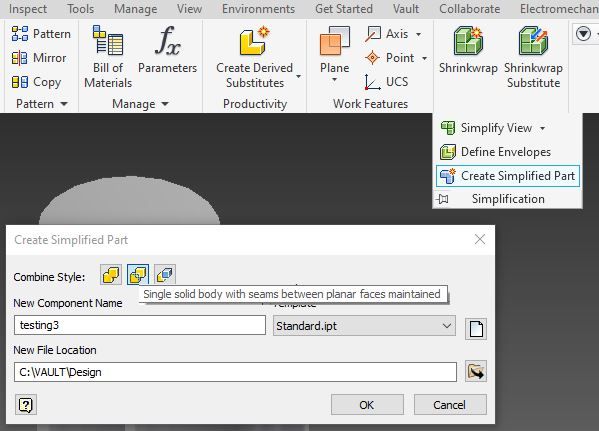

Here's what I would use:
1) Simplify both objects into one single-solid part, but keep seams between faces:
2) Project the intersection and extrude cut:
Result:
The problem is if your intersection is not as simple/linear as that... then use sculpt:
https://www.youtube.com/watch?v=16-8g4igLDs
