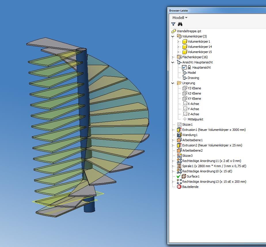

Could be possible like that with MBPs and Designviews:
Problem: Mass isn't ok. Perhaps the dummy steps should be only surfaces.
2017 file attached.
 Later: That's the surface look.
