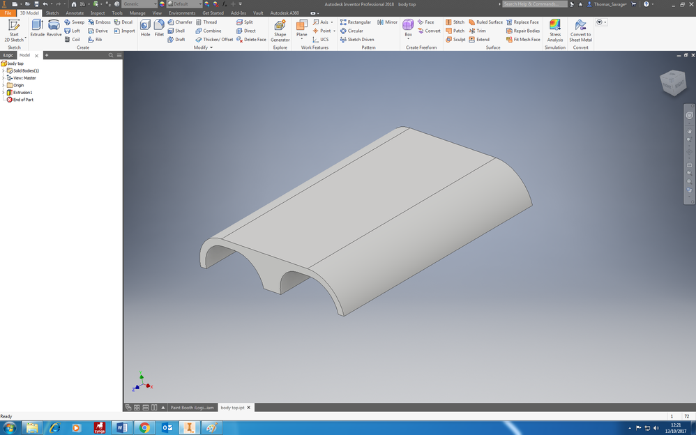

Thomas_Savage
You didn't constrain the point in the corner. So it was not a closed loop.
Use coincident constraint to attach.
I have added print screens so you can see what i mean.
Also you need to fully constrain your sketch.
And it would be best to constrain it to the center point like i have in the print screens.
Thomas.

Thomas_Savage
If you look at my print screens you will see the constraint needed, because it is selected in the 2nd print screen.
Select the coincident constraint.
Then select the end of the arc, and the the end of the line.
Then that will constrain them together.
Hope this helps?
Thomas.

Thomas_Savage
You're welcome.
You also need to fully constrain your sketch.
Do this by constraining to the center point, like in my print screens.
And fully dimension your sketch.
When you have fully constrained your sketch, it will go purple. And will say Fully Constrained in the bottom right hand corner.
The bottom right hand corner will also tell you how many dimensions you need to Fully Constrain.
It is always best to fully constrain your sketches.
Thomas.
