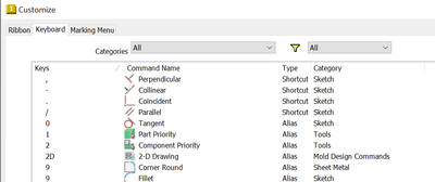

Here is my method. It isn't perfect, but fast enough I think. I use Alt+V to Hide Parts or Components (Sub Assemblies) and "V" to to bring them all back in view. This is by way of an External iLogic rule. This works on Inventor 2024, when external rules can be accessed in Tools -> Customize -> Keyboard for shortcuts, an amazing feature!
In Tools -> Customize -> Keyboard I use:
- Press 1: Part Priority (this is so I can quickly select between parts or subassemblies, for viewing editing etc.)
- Press 2: Component Priority (if you want to hide a subassemby)
- press V: Set component visibility (this is the external iLogic rule)
Here is the external rule. It refreshes the view representation and relies on "Default" View to exist. It may have to be adjusted if you have View Representations labeled differently. If you're working in an Assembly it sets all components to Visible, but hides "Referenced" components. If you're working on a Part, it calls a second rule "Set Surface Visibility", which is the second code I attached here. Please make sure the path of "Set Surface Visibility" is defined correctly.
I hope it helps. If you don't have any experience with iLogic it may be daunting, but you can do sooo much with iLogic, I think it's worth learning the basics at least!
