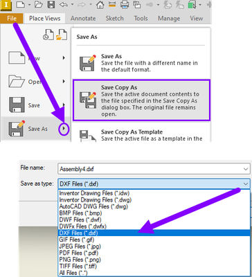

Manually, you can save here:
If you are looking for automation for batches of files, search the Inventor programming/API forum:
https://forums.autodesk.com/t5/inventor-programming-ilogic/bd-p/120
Or perhaps use the Task Scheduler: Create Task > Export Files > pick "..." with DXF as Output:
