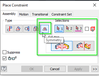

I have a question about the mirror feature in Inventor. Every time I make positioning changes to the original part that has been mirrored, the other part doesn't follow the changes. How can I solve this problem without having to reposition the mirrored part again? The purpose of the mirror feature is to generate another part inside the assembly that continues to have the same relationships of the original part selected in the feature. That's why I kept the + symbol in the command setup.

1)If you are using Inventor 2026, it will work like you expect. If you change the source position, the mirrored part will follow that change as a mirror. (It's a new update for the Mirror tool).
2)If you are using Inventor 2025 or below, the mirror will place the mirrored part well placed the first time, but the mirrored part will be locked in position (grounded).
If you intent to change the source part position and expect the mirrored part follow that change, you will have to unground the part and add additional constrains.
Tip: in that cases, i used to apply symmetric constraints between the source part geometry, the mirrored part equivalent geometry, and the mirror plane.

Thank you for your reply! However, I currently have the 2026 version and the mirrored part still doesn't go with the original one. Would you recommend doing the same as your answer for the 2025 version? If so, what's the difference between that and making a copy of the part, and positioning it again?

In the Mirrors dialog box, you must make the appropriate settings to preserve associativity.
Since you did not share the files, we do not know what you did or did not do.

Hi Carlos and Kacper are right. Mirror Components should just work in 2026. Please share an example that illustrates the behavior here. I would like to understand it better.
