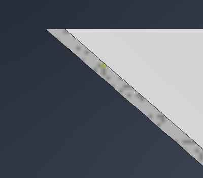

This cross section for shell

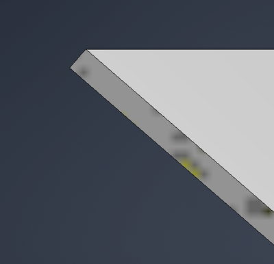

This is from Thicken

n_Sovljanski
Hi, I forgot two important things.
1 For thicken command input desired thickness
2. Convert your model part in sheet metal part
Message 8 of 8
SCASTILLO-RMI
Thanks for the pics, they pointed to the problem. I squared off both edges perpendicular to the rip line - as you show in your second pic - and the command worked.
