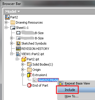

Now, this doesn't automatically show the sketches either, it just exposes them as nodes in the view browser.  So, expand the node for your part, find your sketch, then right-click it and choose Include.
You should now see your sketch.  Check the view scale to make sure it is 1:1 (double-click the view to see the options).
