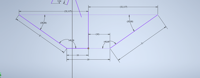

plz fix this - some wird display of the propram - have to be a bug.

Both sides are not the same size. they are clearly different - The numbers gasslight what i clearly see.
They are NOT identical.

Can you attach an ipt. for members to see? Very difficult to help with only a picture.

I see nothing wrong. Tried to make the same sketch in v2023.5.2 and all is fine. I have even tried to use my ruler on your sketch on the screen 🤣.
What is the issue?
Try to mirror one side to the other to clarify what you mean. And/or try to get your sketch Fully defined.

Going to ask some freinds IRL if they cant see it. its clearly not the same size on my screen as the other - perhabs its all in my head. Going to ask some freinds
I mean, come on, how can you not see it ?

Can you point out what is not identical from side-to-side?
Are you referring to the Construction linetype?  Why not toggle it to Normal linetype?
Is there a logical reason you are not fully defining your sketch?

I be back later this weekend - i moved it there - as i cant share my work online. I am sure you understand. Everthing is allready mesured up, and i tried being autistic about getting it identical on both sides, and failed, thus the post.

half say its different, while the other half say its identical on both sides. I asked AI who said this
Im unsure what to do with this.
But its very clear for me, that the sides are not identical, and this makes me uneasy to trust what i see, as the Measurements are not real/eyes lies.
as some told me, Use mirror. And that fix it. so i assume its fixed.

You have not pointed out any differences.
Fully define your sketches and end all doubt.
It is very clear to me that the sides are identical.
Show me a mirror that results in it being "fixed" when there is nothing to fix.
