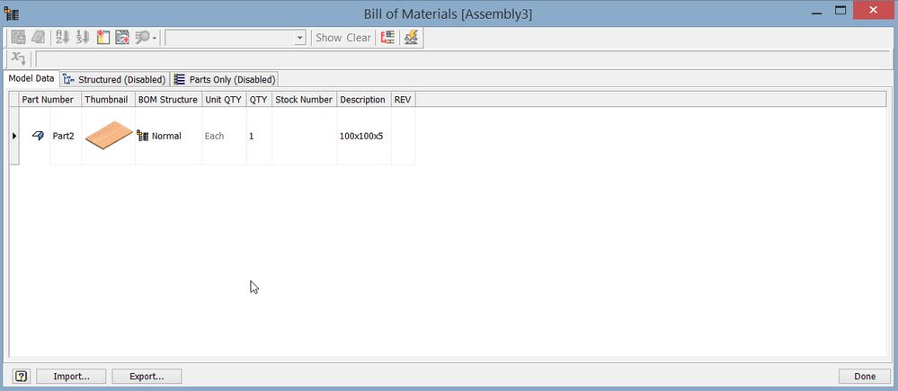

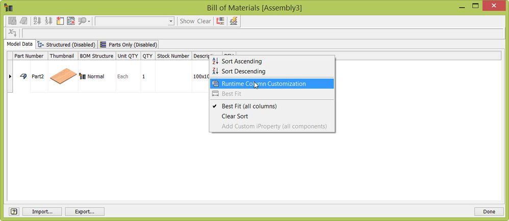

Hi
There is an easy solution for your problem, at the assembly environment , click below the description column beside the part you wish to add the dimensions to it and just write it, click done, and you'll have it in your parts list.
I f you don't have the Column, you just right click on any column there and select run time column customization , all Column will be displayed, select the desired keep click and drop it beside any of the existing column you wish ...
Hope pics down will help
for further question and tutorials I'll be glad you visit to my channel on you tube
https://www.youtube.com/results?search_query=ebrahim6000
have a nice day
Eng.Ebrahim
