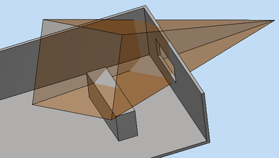

It looks as if the border of the detail view is projected "into" the perspective view.
dan_inv09
Something like this:
It's like the detail view is orthogonal but its border is projected using the perspective.
