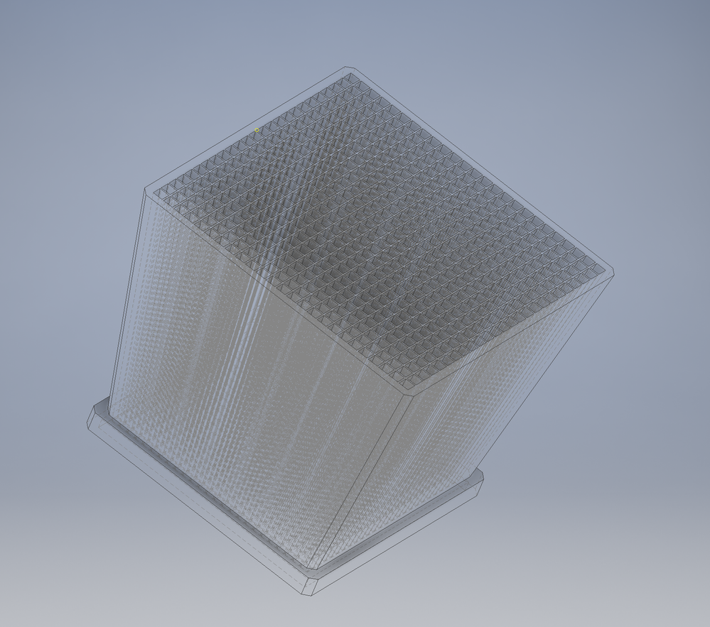

Hello, I'm trying to make Pattern Cut using Loft. the upper surface has 100 rectangular hole with 5x5 and the bottom has also 100 rectangular hole with 3.2x3.2. the size of upper surface is 52x52 and the bottom is 44x44 with height of 40mm. When I tried to make through cut using Loft, one 5x5 hole to one 3.2x3.2  is possible but hole pattern to pattern is not possible, if anyone has good idea of making this easier, please share. thank you.

I don't know of an "easy button" solution to this, but at the very least you only need to do one quarter of the individual sweep/loft cuts; the rest can be created by mirroring the first quarter.

Here's one way to do it.  Instead of creating the holes, I created the grid between the holes, and did just a quarter of it with two mirror features to complete it.
Also, I centered both top and bottom grid patterns (required for the mirror to work properly); note that your bottom grid is not centered.

Hi! There might be other ways to do it. Here is a solution, not precise but kind of close. I used a Guide Rail Sweep to do it in one shot. Please take a look.

thank you for your reply. It seems what I've thought....problem is if the hole is not just 100pcs or the array is like 15x15 in this case the circular array can't be used. actually my actual modeling has 725 tiny holes..however your suggestion really helped me a lot.

Hi! You are more than welcome! This is a very interesting exercise. Actually, the Sweep can work the other way too (from bigger side to the smaller side). I notice that the dimension was specified only on the smaller side. So, I assume the other side does not need to be as accurate.
Loft is a powerful tool. It is more like Freeform. It can generate shape quickly. However, it is under-constrained. You don't have total control over the shape. In mechanical design, Loft should only be used when the shape is indeed under-defined, like transitioning from a square to a circle.
Sweep is a much more rigid tool. Its definition is clearly defined by a profile and a path (plus guide rail or surface). If you use the same geometry input in other CAD software, you will get the exact same shape.

@johnsonshiue I think in this case that Loft does give a precise and repeatable solution; all the faces are planar and edges are linear, which is exactly what one would expect.
@flightyan Here is another attempt, this time with:
  • odd numbers of holes in each direction
  • not square
  • only two loft features plus two mirror features
showing that this can be extended to a variety of problems.  I will not volunteer to do it for 725 holes(!), but I think it can be done.

3D Shape.pngAs you mentioned, my problem was the fixed dimensional requirement, I made sketch for bottom side and used sweep with guide rail, not cutting. Of course it is hard to get the accurate size of upper rectangle, however by resizing the height and bottom, I could get closed number of what I originally want to have.
I'm going to 3D metal print with this drawing.
