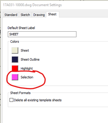

I like the new (2024) feature to highlight parts in a drawing view when they are selected in the Parts List.  However, the dark green color does not jump out at me.  Does anyone know if there is a way to adjust that color?  Application options, XML, or registry.  I would like to make it a bright red or orange so it pops out at me.

Hi Scott,
You may want to look into Tools -> App Options -> Colors -> Customize Color Scheme.

When selecting a larger part, it works okay.  But when you select a smaller part like a screw, it's still hard for me to find it even on this very small assembly.
scott_ainsworth
I looked there first, but I could not identify which color to adjust.   I thought someone might know already.
scott_ainsworth
Turns out this is a document setting.  I'm not sure why, It seems like it would be more user dictated than document setting.  It does not really impact the final document.
