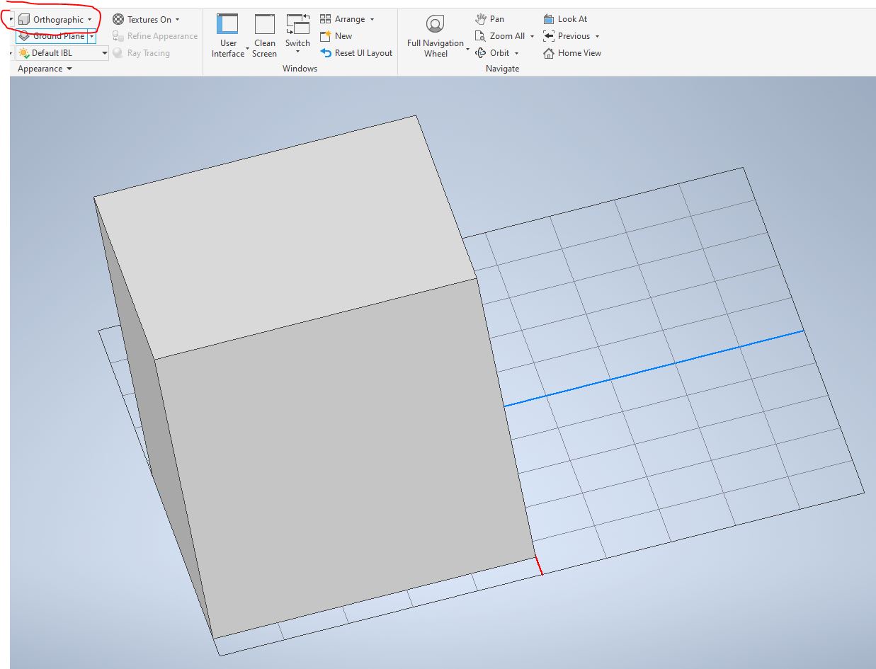

This is driving me mad. Orthographic view looks like a perspective view, but in reverse. The edges in front of a cube looks smaller than the ones in the rear!
It has been there since V 2020. I am using V 2022 now. Some unknown setting has been very persistant in the past couple of upgrades.
The screen shot is taken in normal part editing environment. Even the ground is clearly showing reverse perspective.
Any ideas? Thanks.

Could be just an optical illusion to your eyes. Grab a ruler and measure on your display and you will see the distances seem ok and not smaller in front than the back.

Your screenshot looks Orthographic to me.
I copied your screenshot - painted a vector line over the rear upright edge, then moved the line around to measure the other two visible uprights.  They are all identical.  I repeated the process with the 'horizontal' edges and got the same result.
I then copy/pasted the line - moved each copy into place - then moved them together, and they are about as parallel as the calibrated eyeball can manage.
I recreated a 100x100x100 cube - but changed the visual style to show hidden lines so I could easily identify the back-left-bottom corner - and it still looks orthographic to me:

I really appreciate the time you spent on this, very grateful. After receiving your note, I measured the lines and they seem fine. But still the shape did look skewed, so I connected to my son's monitor and everything looks fine there! Can't imagine how a monitor can play tricks on your eyes, but it did!

Make sure you're using the recommended resolution for the monitor you're using. If not, the width/height ratio might be incorrect and equally long objects may appear different.

I have been trying different settings. With a more square setting (like 4:3 or 5:4) it look better, but obviously I lose a lot of space here. Anyhow, I guess this is now a hardware problem and I would take it to the proper forum from this point forward. Thanks again for your and everyone's comments.

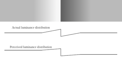

It's just the way the lighting hits the object, causing the left face to be darker, which adds a perceived sense of depth. No way to fix that with monitor settings.
I love watching optical illusion GIFs, so I am more aware of how lighting and color can cause perception of movement and/or stretch. We are also very used to Isometric views and Ortho takes a few days or weeks to fully adapt to.
