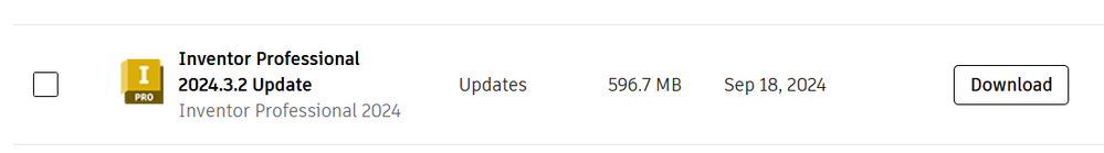

Alexander_Chernikov
Hello, try to install the latest update 2024.3.2
