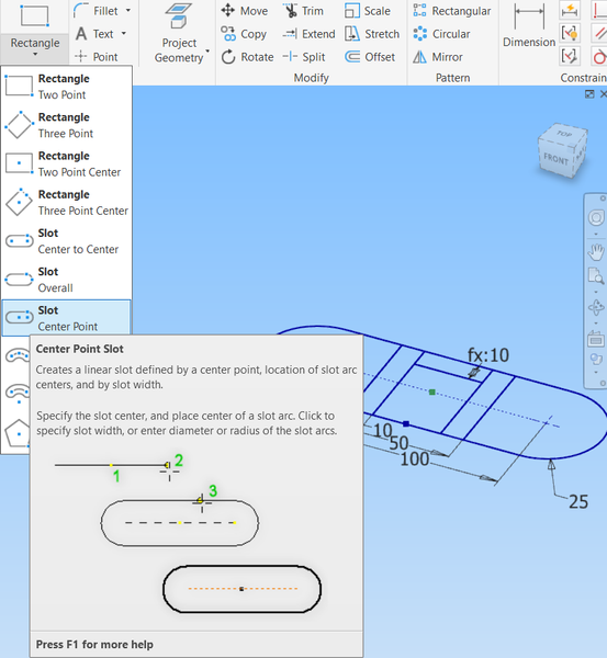

If anyone has time to offer a review and comment on the attached part exercise.
The goal was to use the BORN workflow.
Thank in Advance
-Tim C.

Your effort is good. To see, what can be done slightly different - please have a look at the attached part in IV2020 format.
Open up Parameters DB in both files (yours and mine) and compare the amount of entries in both of them. The less entries - the better. 🙂

See Attached...
timothy_crouse
I did not realize that was a thing.  Make sense thought, Thanks
timothy_crouse
Nice slot short cut tip, thanks for the multiple reviews.
