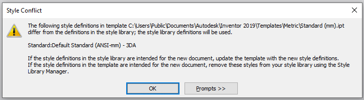

I'm new to Inventor, just following along this tutorial https://www.youtube.com/watch?v=5PWqsRynm5I and I ran into some problems. Using Inventor pro 2019 , on Windows 10 u1909 x64.
First I run into template problem when creating new part/assembly. Only time I don't get it is new presentation.
I tried googling for answer but didn't come up much, access rights isn't the problem. Reinstalling doesn't help either.

So those are the weird errors I got... Adaptive flag somehow needing reapply, screw hole doesn't get detected automatically, and bolted connection runs into error when setting up. On top of style conflict. I already tried reinstalling Inventor, as mentioned above, and that didn't make much difference.

Regard to the style confliction, please click prompt and select the 4th option to stop telling for ever.

Hi! I believe you are on Windows 10 build 1903. You need to install 2019.4 update followed by 2019.4.3 update (or the latest update).
The other issue might be related to the following thread.
https://knowledge.autodesk.com/support/inventor/troubleshooting/caas/sfdcarticles/sfdcarticles/Style...
