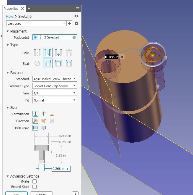

I'm trying to get the hole in the center of this part.  I have selected the face (way off center to make a point).  When I select the edge though to give a reference for where I think the hole should be located (IE the center of the face), Inventor tries to put a hole on the edge.  I'm left with two holes with neither of them where I want them to be.
Any help on what I'm doing wrong with the new hole command will be appreciated...

chris58
I put a sketch on the face and placed the hole on the sketch.  I know that's not how it's supposed to work, but couldn't let that stupid little hole hold me up any longer...

chris58
Yes the part is cylindrical.
Message 8 of 15
chris58
You were able to put a hole in the center on this part that I attached???  It's still not working here.  I tried selecting the face, then selecting the edge, and selecting the edge, then the face.  either way, I end up with a hole on the face, and one on the edge.

Wrong profile (projected spline rather than circle) in Sketch2 used for Extrusion1 - part is not cylindrical.
Sketches not fully defined.
I recommend that you convert your Projected geometry to Construction and then fully constrain your profile geometry (circle).
I (almost) never use Projected geometry to create features - I only use it for construction reference.
I (almost) always fully define each and every sketch entity as I create it.
Spline.PNGYou should have noticed that you could not snap the center of this circle to the spline.
You will need two additional sketch points for that. (3 points define a circle)
No dimension needed.

TheCADWhisperer
No.
The issue is entirely and completely in Sketch2.
In Sketch2 you have a projected spline that sort of looks like a circle, and overtop of that spline you have an “eyeballed” circle. When you did the Extrude you accidentally selected the spline rather than the circle. This accident could not happen if you had changed the spline to construction.
