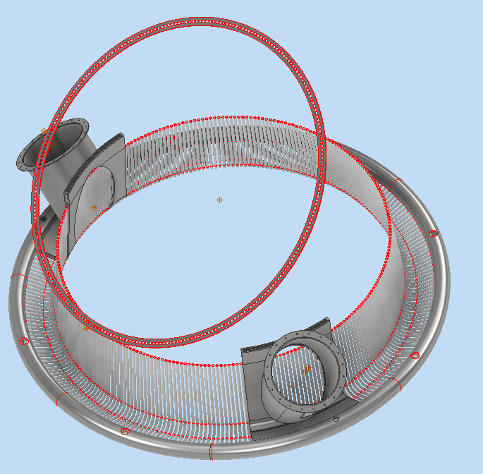

I need help with Inventor in making out tubes (1.5" od) which are running in different planes.
So I have a drawing as shown below and we need build this in our shop. I need to make drawing for tubes so shop guys can bend this. Please not the tubes are not allow to welded to make them bends. They have to be one piece.
So far I have made the lower header tube and top plate as shown in snapshot below. I have also made tubes in bottom header as they are similar up to that point beyond which they are running at different angle to match with top plate holes.
Is there anyway I can make this faster in inventor.I can make the tubes one at a time which is not preferable as It is very time consuming. These are 260 tubes so 260 different parts I have to make.

How are you going to convey the information to the shop?  Will you be making a drawing for each tube?  (my sympathies if you do)  Or export individual tube models to a bending software?  Or do you need the model to just be one part, you put on some general dimensions and rules and the shop figures it out?

Basically I am hoping to make this virtually and then I will make drawings for tube and if they differ in one or two parameters I will make a table for the shop guys.

What a fun problem!  Try the workflow in the attached part, I don't have 2021, so I was only able to view your part.  This method only works if the to and from points have the same circular pattern and diameter, and the ends are perpendicular.
First step is to create the bends and pattern them along the intersection plane.  I do this by projecting 2d sketch points to the intersection plane to a 3d sketch.  Then, select those points, right click and convert to center points, then create one bend and use a sketch driven pattern to pattern all the bends.
The extrude the lower part of the tube, using "to next" termination and circular pattern with the "adjust" option.  Repeat for the upper part of the tube.  Hopefully that makes sense!

Thank you so much, that helps a lot. Actually to and fro point have different  diameters but I figured out a way how to carry on this further to make it work.

Looking at the sample file from my post, it looks like I created a new 3D sketch and used "Project to Surface" command, select "Work Plane 3" in the faces box, and select all the points in Sketch14 for the curves, then click OK.  That will project the points from sketch 14 onto work plane 3.
Let me know if that answered your question.
