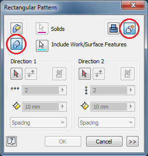

If the 20 x 20 array is a rectangular pattern, edit the pattern and change the options to Pattern solids and Create new bodies.  Then you will have 400 separate solids without all the trouble and repetitive stress of splitting each one.
Hope that helps.
