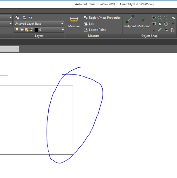

mcgyvr
@Anonymous wrote:
Thanks for your response...
I have tried the Inventor DWG and again we still have the issue with muddy lines.
@Anonymous
Care to explain more/show examples?
I can create an Inventor DWG file and open it in DWGTrueView and do not have a problem with "muddy lines" whatever that is...
The line work is very crisp even when zooming way in..
This circled line is .009" long and I've zoomed way in
Its very crisp/clean..

jtylerbc
I am similarly confused.  I'm looking at 2016 at the moment, so maybe something has changed, but as far as I can tell you can't display lineweights in TrueView even if you want to.
Perhaps @Anonymous is mixing up "Inventor DWG" and "DWF"?  I can definitely understand having issues with the chunky line display with DWF.
