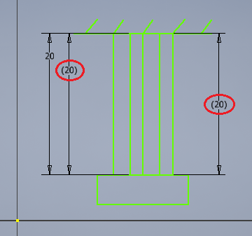

Maybe better explanation on sketch with 4 gears (lines)
First gear position is given by dimension 30. Second gear position is given related to first (20), third gear position is given relative to second and fourth gear position is given relative to third. So far sketch had DOF = 0. I can change position of all gears ("rotate all gears in gear box") by change of 30. When I add relation/dimension between fourth and first (60) sketch gets over-constrained - similar to 4 gears in gear box. XY center/origin represents gear box (frame)
4 gears4 gears
Regards

1D and 2D Constraint1D and 2D ConstraintThe novelty you brought was that this occurs in 1D and 2D with was expected, showing that this behavior is intentional, not a BUG and is the working philosophy of Inventor.

Lines supporting weightLines supporting weightFor example: YES, a line is enough to hang a weight, but in the Real-World we can have in parallel how many lines we want and I can define the length of any one, if we vary the lengths of these N lines, the weight will move and the position of the weight is defined by the shorter lines of the same length, if I cut (delete) a shorter, the next shorter ones take up the weight dynamically. I can vary/control/distribute the stresses on the lines by varying their lengths.
In the Inventor environment this is not possible with constraints.
In the Real-World the same occurs with four looped gears (as in the initial image of this thread), the angular position of each gear is defined by its two adjacent gears, each gear receives movement by two distinct paths that divide the forces of movement, this is an over-constraint in the Real-World and this does not cause problems and the movements are free, we continue with the same DOFs. If one gear is removed the other three still continue to rotate because it still has the other adjacent to transfer movement to it.

@jan_priban  showed us in the posts 27/34/41 that:
Do not.
"A MOTION CONSTRAINT CLOSING A LOOP CAUSES OVER-CONSTRAINT THAT LOCKS MOVEMENTS" and an over-constraint is a mathematical artifice that creates problems and locks up movements only in the Inventor environment very different from behavior in the real-world environment where an over-constraint causes no problem.
But @TheCADWhisperer  showed in post 24 an alternative solution where a loop is possible using 3D Contact Joints.
It's anti-natural and very uncomfortable to live with this artificial over-constraint in the Inventor environment, Autodesk could study a way to improve and us get rid of the problems created by over-constraint.
