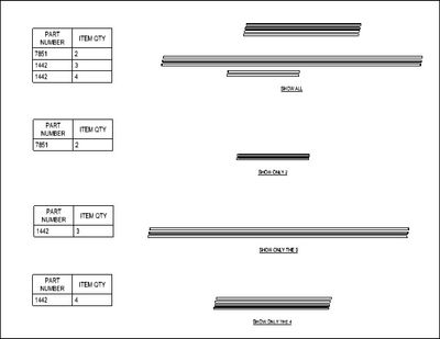

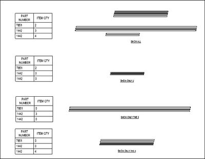

i have in my assembly some parts with model states. I have set up some assembly level model states that suppress some parts. When i place the assembly into a drawing as a base view with the selected Model State, the part list still shows all of the components that have been suppressed with a qty of 0. You wouldnt show that on a BOM typically, you only want to show what IS in the assembly. The other components are suppressed meaning, not in this version of the assembly so how can i set it to not show these 0 qty columns? I know that we can manually edit the part list and turn off the row visibility but long term, with lots of components and lots of part lists, that will quickly become tedious and not something we want to place either in automation or to the designer.
just need a part list that only shows the parts reflective to that model state assembly and not show the suppressed components as 0 qty callouts...
How it looks
How it should look
If there a way to change this, please let me know 🙂

If you search the forum this has come up several times in the last month. Plenty of solutions there.
  Inventor Certified Professional
SharkDesign
To quote Johnson,
"This request had been debated quite a bit within the Inventor Feedback Community during the project cycle. I personally think it would have been better if there was an option to hide the QTY zero rows. It seems that most test users want to see the zero rows so they could hide selectively."
There's also an iLogic option.
https://forums.autodesk.com/t5/inventor-forum/hide-items-on-part-list-with-qty-0/m-p/10460492

Hi! The ability to hide zero quantity row is being worked on. It is probably targeting the new release (not 2022 updates). A testable build may be available on Inventor Feedback Community in the later part of the year.

Thank you both for your responses. I wasnt keen on the part list option as thats a little slow so i wrote up some code to iterate through the Model States and change the suppressed ones to reference
works like a charm 🙂
