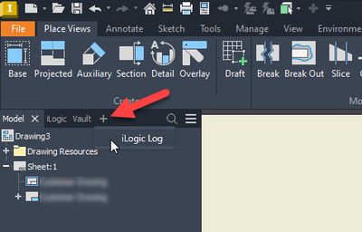

While within any file type (iam, ipt, idw), the ability to add the iLogic Log is missing from the expansion. The only way to access the iLogic log is from the View\User Interface ribbon, which was previously not required. Activating it here does not create it as an item in the + 'Show tabs' menu in the browser pane, although it does create the tab.
Also of note, IDW files had the + missing completely, but after some jumping between .ipt and .iam files and using the + there, I was able to get it to return in the idw file.

How odd!  It's there for me in all environments (2024.1.1)
Accessible through "+" and "User Interface":

Hi Johnson, thanks for the input. I have tried this now, and although I had an iLogic tab present in a drawing after the reset, once I closed the tab I didn't have the option to open it again. I had to go through the View ribbon, User Interface, and select what I want. I haven't loaded any exported settings/customised Inventor since the reset.
When I close ALL browser tabs, these are the only available options to create. Surely iLogic and iLogic Log should be included here (at the very least iLogic)?
Edit: I'm not sure if the 'Reset UI Layout' should address browser panes, but in my case when clicking it, my browser panes remained as is (non-existent as I had closed everything). iLogic or iLogic Log did not appear under the + menu either.

- In first, post I start look same "User Interface" setting. But I was missing those option as well -> "iLogic", "iLogic Log"
https://forums.autodesk.com/t5/image/serverpage/image-id/1262507iBBB385232A32D7FE/image-size/medium?...
I again, close Inventor, start Inventor. Create new part.
Then suddenly, those options appear in my program and are working.
Seems, it needed little wake up.
