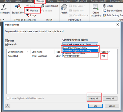

Hello @karthur1,
It seems a 3rd OLE is linked when leverage texture image from non-system path.
First of all, please check if the image from system directory or not, hover concur in the image title and the path display as below.
If not the case, please navigate to system texture path to solve it.
or
Try below steps to solve it.
1. Go to Application option -> file -> Texture folder and set to the correct folder which contains the image.
2. Close and restart Inventor.
3. Go ahead to edit the weld file as usual and edit the appearance asset, navigate to the texture image from application set directory.
Hope it helps!

Hello Kirk,
OK, see the reason here.
The images on my previous thread is the default setting. I believe your local "Weldment Aluminum" asset has been edited by someone since the name shows in your video as italic bold which means it is not match the library default one.  (Bold means in-use and italic means different from system library) Beside, The default texture image should from C:\Program Files (x86)\Common Files\Autodesk shared\Materials\Textures\XX\Mats folders as what've shown in my snapshot above.
Try to leverage command Update to solve it and go to OLE dialog to clear the link or clear the use of currently "Weldment Aluminum" asset and delete from local and reassign to the object from system library.
Hope it helps!

Hello Kirk,
Thank you so much for the data and it is exactly the problem what've mentioned in previous thread, the in-doc appearance asset is not match library one. From your latest screencast, it shows in Italic as well which means this one is different than library one.
To solve it, just simple click Update command and choose Inventor Material library or Autodesk Appearance library, and check Yes to update, both should works.
About the unable to remove, it is because the Weldment is consume a Weld material when the file initialized which is expect, to remove it, you have to choose another weld material first. So, it's the nature of Weldment file.
Your Inventor material library look correct, however, there is no texture missing sign "X" in the thumbnial which is abnormal, please remove the texture image "weldcat0.png" from (C:\Users\Public\Documents\Autodesk\Inventor 2019\Textures) before make the update operation.
Hope it helps!
