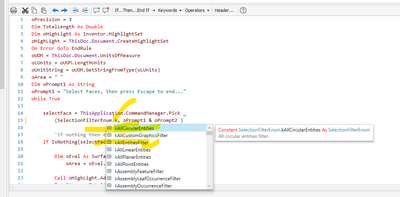

Hi @Curtis_Waguespack
Is there a way to modify this for round surfaces eg. cylindrical surface? I can't select them using this rule.
Thanks!
Curtis_Waguespack
Hi @R.nnie
I think you can change the line as shown to kAllCircularEntities or kAllEntitiesFilter to meet your needs.
I hope this helps.
Curtis
R.nnie
@Curtis_Waguespack
Thanks a million, this seems to work the charm!
I have another issue as @ajremillard mentioned the units conversion throws my result off by a decimal place (working in mm).
I'm still fairly green when it comes to ilogic but would it work if I chose a different function for the ConvertUnits which could just get the value as is in mm?
Curtis_Waguespack
Hi @R.nnie ,
I think just adding /10 as in this example should do it.
I hope this helps.
Curtis
		oPrompt2 = Round(oUOM.ConvertUnits(TotalArea, "cm", _
			oLUnits), oPrecision) / 10 & " " & oUnitString & "^2"
