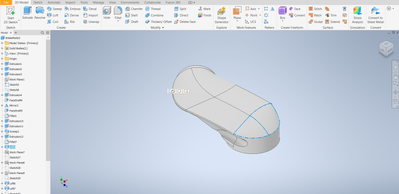

All solutions I've been able to find online refer to checking that all geometry is constrained and that often being what causes issues when trying to use the shell operation after a loft. However, all the geometry in my case is constrained and all other features aren't interfering with the shell (I know this because the moment I suppress or delete the loft the shell works perfectly).
retzcay7N6SV_1-1685749609478.pngretzcay7N6SV_2-1685749615691.pngretzcay7N6SV_3-1685749620154.pngretzcay7N6SV_4-1685749625990.png

But if you must use it, as in your application, the main causes that I've found for Shell failures is that the resultant surface offset has joints that are impossible to build. One cause of that is too small inside radii (less than the Shell thickness) between surfaces or corners that will collide into other features. Another problem is disappearance of a feature due to too thin a bridge with another feature. This is the kind of thing to look for.
In order to make your shell work, it must be able to offset your surface so that the shell thickness won't cause modeling impossibilities towards the side of the shell that's being created.

The thickness of the shell is too large to keep the offset geometry of all faces.
Check the shell at 0.05 in - it works.
If you need a thicker shell, you can work around this manually.
Create a thin shell, then try to thicken successive surfaces (or groups of surfaces) one at a time. Combined with the Delete face tool at intersections of surfaces too small to offset, you should be able to get the desired effect.

Right off I can see that the thin edge along the side is .151" wide.
So if you offset the adjacent surfaces, you subtract .1*2 from .151 = -.049.
That means Inventor is trying to offset the 2 adjacent surfaces .049" into each other.
That's a collision, so the Shell won't work if you shell to the inside.
But if you shell to the outside, it'll probably work.
You have to plan ahead as much as possible when you use Shell.
See the below screen_cap from Rhino3D showing which edge is too narrow to allow the shell.
If you make a Parameter for your shell thickness and then use that parameter to make sure that strip is slightly wider than twice the thickness, it'll probably shell. That's t*2+.01 or something like that.

I deleted the 2 capped ends and then offset 0.1 to the inside, and this is the result in Rhino3D:
It failed on that sharp edge at the transition.

The tight radius there is kind of necessary for it to fit in what little space it has, but it’s helpful to know that is one of the problem areas along with the sharp transition. However, what I struggle with is that if I suppress that sharp transition in the nozzle and make that curve you mentioned larger, it still refuses to shell for me in autodesk

Thank you for being willing to take the time to look into it, I’ve spent more hours than I’m willing to admit stumped on this thing. I have tried shelling outward as well as inward and just about any other thing I can think of with no luck. The furthest I’ve gotten is being able to shell inwards at 0.00001in of thickness while suppressing the loft from the half-circle to the rest of the shape
