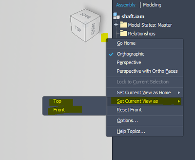

When I model, I model with the top of my models viewed using the view cube top selection.
I would assume the lighting to be from above the model, yet it comes from below, is there a simple way to set the lighting to be from above? or should I model everything upside down?

It's based on the view cube, so quite often if you just change which side the model views as 'top' then the lights will change.
Are you using studio or just normal environment?

I am using both, but when using studio all the detail I want to show is in shadows.
If I change the orientation of the part to view cube using set current view to, picking the top of the view cube and selecting view as front, the lighting is from above till I use either inventor studio or ray tracing, then the lighting flips to being below the model.

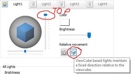

Gabriel_Watson
Change light styles for your model (or update that in your overall styles to affect other components too):
Click to de-select the second light if there is one (usually there is on Inventor's templates), then alter your first (keep in mind the angle +90 will represent a light coming from the "TOP" plane, so you have to set the top to the preferred angle):
