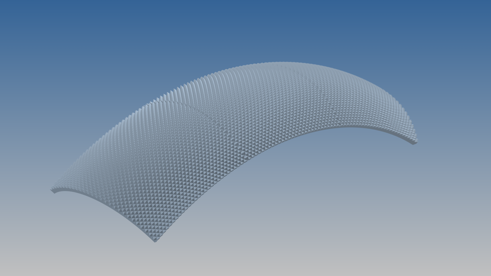

S_May
@Anonymous
here is a pattern..... 🙂
