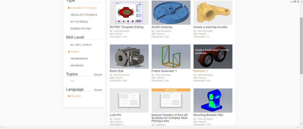

I don't know if any of you have investigated this new (related) functionality in Inventor 2017 - but I thought I would make my hike up the hill public so that you guys and gals can help, push, pull or drag along with me.
1. Issue: I see the video in Edit, but not in Play Tutorial.
2. Issue: How to I get Pop-out to work.
3. Where is this thing in the clouds?
Ping @kgilham

I_Forge_KC
As for number three...
I found your tutorial in the same tool under all available.

Message 4 of 9
kgilham
JD,
Thanks for trying this new functionality out.
First for your video issue here are some steps to help debug the problem.  Play the tutorial again, select the play button (which currently doesn't do anything for you) and hit F12.  You should see a chrome-devtools screen like the one I show below.  Select the Console tab.  If we are having problems opening the video there should be an error there that may tell us what is causing the problem.
For the flashing graphics it looks like we are saving the tutorial rapidly which is causing the screen to flash like that.  I'm not sure what would be causing that but we do have a way for you to create a log file to send us that could help us identify what may be causing this.  If you set an environment variable "Lwsdebug" to 1 and then restart your computer we will generate a log file here: C:\Users\Public\Documents\Autodesk\.desktop-connect.  If you run into that issue again feel free to copy that logfile here and we can take a look at it and see what is happening.
For your third question, were you asking about how you can access your tutorials or where we actually store them?
Lastly when you shared, it looks like the picture and video weren't packaged up when you published.  If you select your tutorial that you have shared and select the share button again, there should be an option to Remove Share.  Can you try removing your share and then sharing it again? It could be that for some reason we didn't package up the video and part before we uploaded it to our servers.  If this doesn't work we will have to try some behind the scenes tricks that will tell us where we are having problems.
