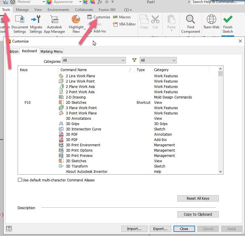

You can create Keyboard assignments to command using the Customize dialog.  You can find it here:

As pointed on the reply above, but also make sure to checkmark "Use default multi-character Command Aliases" to get the full "AutoCAD-like" experience, instead of only one command per keyboard key.
You should also look into regular UI shortcuts by pressing ALT once and looking at the tooltips on the ribbon and menus, and keep pressing subsequent keys to navigate... this would be my preference usually.
