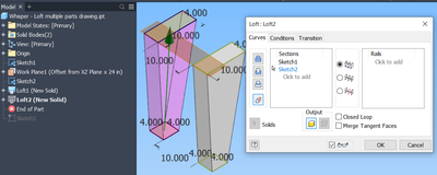

Here would be a basic rendition, I would like to connect the top rectangle to the lower rectangle separately.
JDMather
Your Sketch1 is not fully defined (position of left rectangle in image).
You do not need to duplicate dimensions - use equal = constraints.
Same for Sketch2.
See Attached file as one disjointed body and second file as 2 bodies.
So in summary:
Make the consumed sketches Visible again.
The first pick selects the sketch and the second pick selects the profile (when there are multiple profiles as in your example).  It might not preview the Loft until you click OK.
