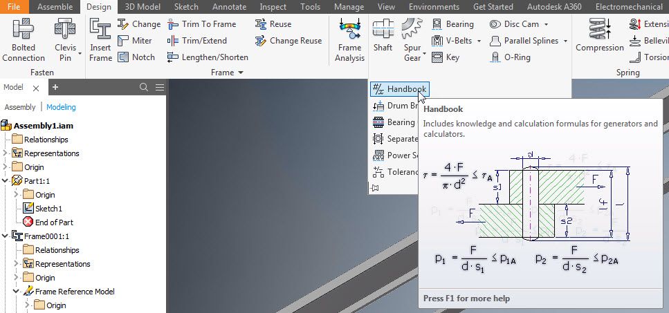

Pavel_Holecek
Dear Sir,
if you are looking for some formulas from Design Accelerator you can find them in "Engineer's Handbook".
- Involute splines English units formulas are here : https://help.autodesk.com/view/INVNTOR/2018/ENU/?guid=GUID-6936BB65-F41D-48AA-9389-5B91A9055D0C
I will check your inputs and results
Pavel Holecek
