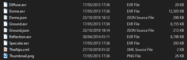

j.pirotte
Hi, I checked and nothing is missing. But some files are from 2013/2014 (see attached screenshot), I don't know if that makes a difference. Maybe you could send me an environments folder that I can import to test if it is due to my files.
Would it help if I reinstalled Inventor? If yes, is there a clean and sure method to do it? Because last time I had to reinstall Windows to get the installation to work.
