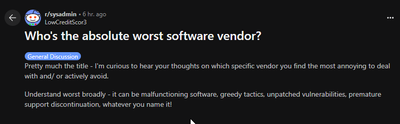

Saw this post today on a popular site.
Didn't have to look far down before we found Autodesk in between Broadcom and other vendors. Maybe it's time for Autodesk to take some time and reflect on what direction they are going. Companies like Broadcom (VMWare vendor) are losing major customers because they are going in the wrong direction.
